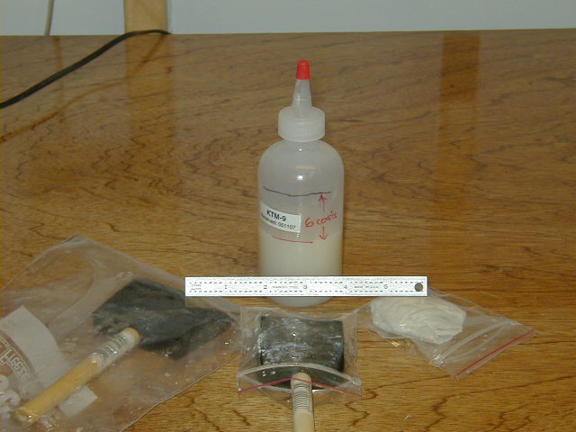

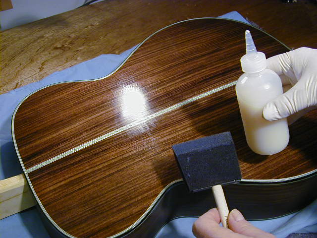

I've had no problem whatsoever using a foam brush with the KTM applied to the very tip only as shown in the photo below. The KTM-9 is used as is with no thinning. The key to avoiding bubbles is not only to avoid having a heavily saturated brush, but also by drawing the brush along the wood slowly. I've drawn the brush as slowly as about 1" per second. That said, I tried once to purposely to induce bubbles by drawing it across the length of the instrument in about 3 or 4 seconds ... and oddly, could not induce bubbles (contrary to my earlier experience). I'm not sure why so many people have trouble with bubbles.
Using this method, the finish goes on surprisingly thinly, almost as if it's squeegee'd on. Besides the obvious benefits, this has the side effect of not building up the large ridges you might get between adjacent strokes of the brush. Note that not much KTM-9 was used in six coats (see photo below). I believe the whole bottle is 8 oz.
While brushing requires more leveling than if spraying, it is easily done. And the results ain't bad either!
